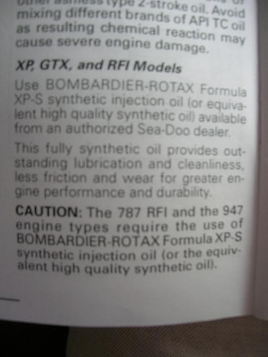

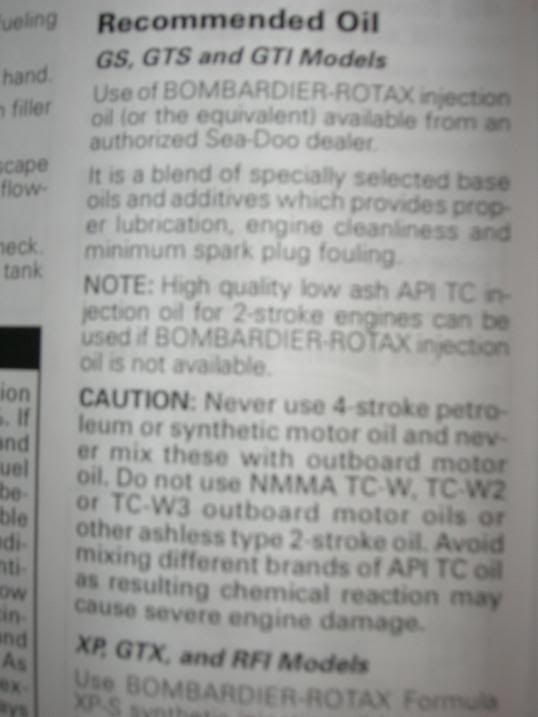

    Well, just in case this helps anyone. Here's what my manual says. It's a 2000 manual BTW..
    Sean
