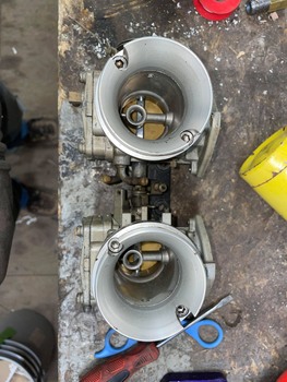

    and here's my used yamaha 44's..
    I already got repair kits and jetting for them both, I guess I have to replace all the linkage also

    Yeah the picture is definitely yamaha 44's (#1) and the link is "straigh from mikuni" 44 (#2)
