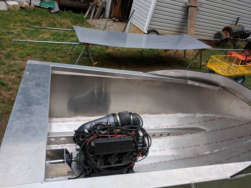

    Hello everyone. I'm looking for some details on possibly building a custom water-box for a Wave Venture 1100 engine. Anything along the lines of the mechanics behind how they are built would be great. Things like back pressure, how much water should it hold, how far should the pipes be underwater, how big should the chambers be? If not, I guess I will just throw one together and see what happens using the details off the original one. I think the original is three chamber but due to space limitations, I am going to try to run a two chamber. I just want to keep the same power, without being it being annoyingly loud.
    The whole reason for building one is due to the fact that this engine is being used in a jet dinghy. Since space is limited, the driveshaft was shorten 13" moving the engine to the rear of the boat. The original waterbox can be pipped in as a last resort but it's doesn't fit and will be in the way of gas tank plans. Most everything I've search states to just use the original, but that's a last resort option. I'm not trying to get peak power out of this engine but I'd also don't want to build something that robs a ton of power.

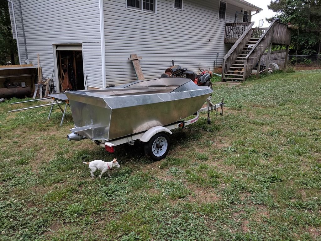

    Pics of tiny boat.

    Basically everything after the expansion chamber will be custom. I'm not looking to modify anything. It currently uses 3.5" rubber hose. I want to shrink it down to 3" aluminum pipe. I really don't want to use any of the stock exhaust parts that aren't connected directly to the engine.
    What's in the pictures will be left as is and everything else will be built from there.

    Quote Originally Posted by INSANEREINDEER View Post
    That should work fine. A bit less power but still should operate fine.
