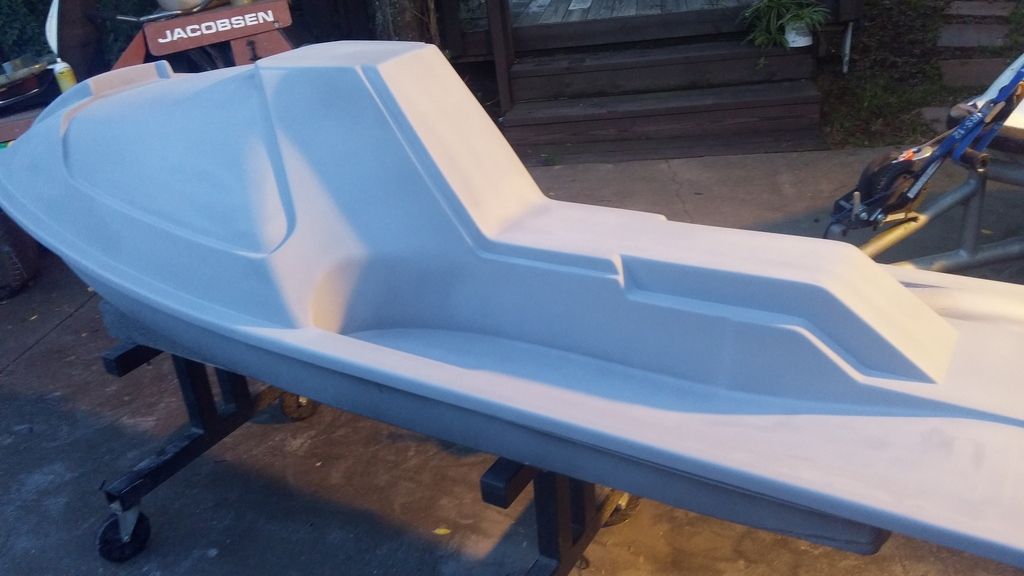

    When your doing something like this there is a lot of time waiting on epoxy to dry so I moved to the front. wanted to round the noes a little. was not a fan of the square corners.
    also started the front fill. decided to fill it for now. If I want to do like a blaster fill I will just make a plug and clay it in the mold. That way we can have it either way with the same mold.

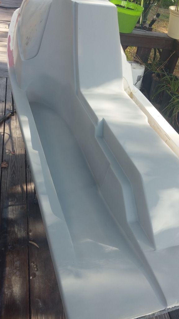

    Got the holes under the seat filled and the back of the ski is starting to look respectable. you will see later why I did the seat area like I did.
    To be able to use it for a plug I had to fill the engine compartment also.
    starting to shape up a little. just set the stock seat on so you can see the difference in length.

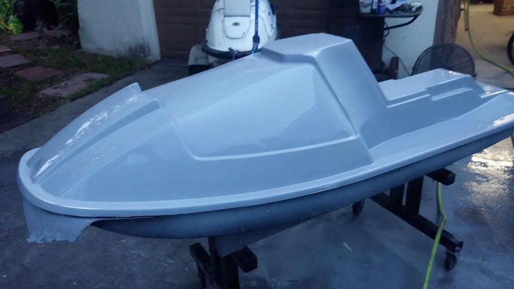

    OK, here we go. Top deck is done ready to make the mold.
    When it is in primer I like to do the final sanding then wet it down just to make sure everything looks like it should.
    looks good to me.
