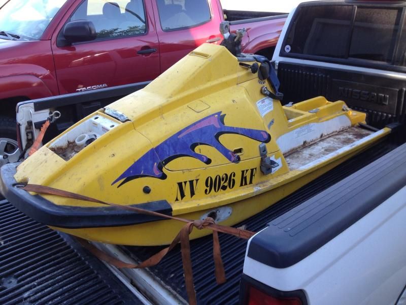

    Ok so about a year ago I bought some tubbies and a front fill. I finally got a decent hull and started the work today, I have a set of sxi jugs bored to 83mm and I will be rebuilding my whole motor (when my funds are right) but as of now my set up will be a lightened stock flywheel big pin motor, Coffman pipe (until I can find a b pipe ), for now I have dual 42s but I possibly will. Go bigger once the hull is finished, hull mods will be , front fill, Tom 21 tubbies,rear exhaust, pump shaft fill, and I will be glassing in a sxr shoe so I can run the 750 pump. I am hoping to race the ski... ( no I haven't raced yet) butttt I will start after this is done.... I will be posting random picks of what I get done after I work on it, I am aware that there are 1000 other x2 builds out there and a lot are probably better then mine but I figure this will help anyone thinking of doing any of these mods.... My motor set up will probably be added to the closer I get to finishing the ski, I am hoping to run a sxr impeller and pick up a r&d stuffer. Let me know what you guys think!

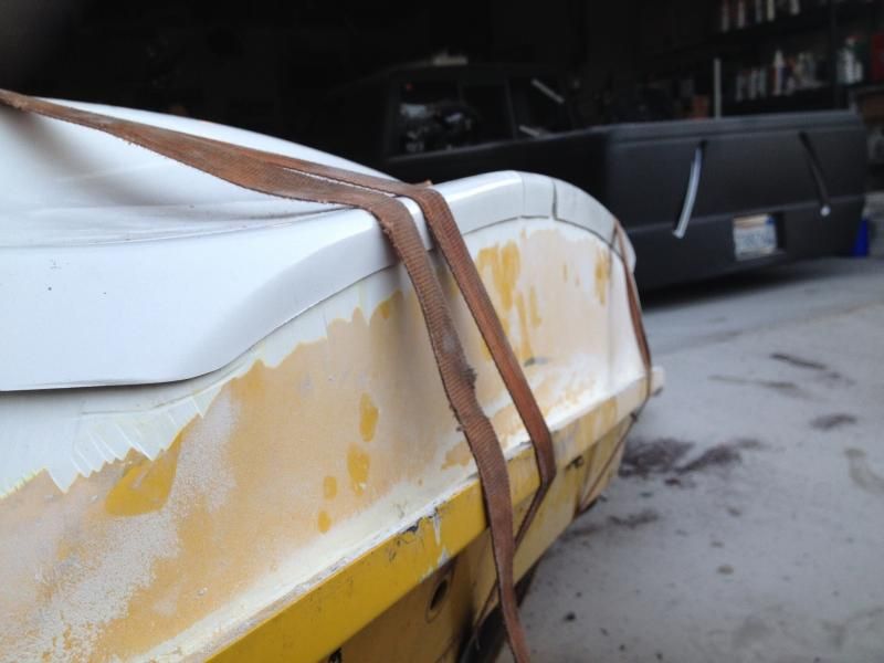

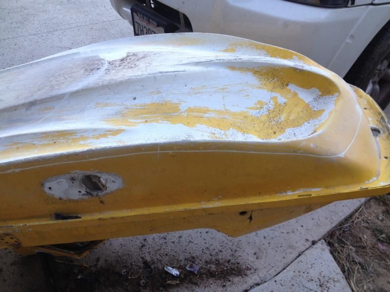

    I started by finishing stripping the hull and I strapped the front fill down, traced where it will sit and thinned out the hull with a thin disk, I still have more to grind but this is close... I made a couple of relief cuts on the front fill to get it to lay down better.

    Is it a 86 or just a 86 hood... those 86 hulls the foot trays will swell if they are left in the sun and get real hot. The foot wells will hump and then the bond rail angles down like the pictures below just something to check and be weary of I think the foam was diffrent in them karty told me that's what happend to this 86 hull I have.
    ( Girlfrends are cheap X2,s are expensive )
    I dream skis mcbrizzlesizzle's Avatar
    Aug 2012
    sacramento ca
    603
    Re: Kawasaki x2 race ski build!
    It's a 86, I know for sure there not as bad as the ones in your pics lol, ill double check but everything looked straight, I and going to thin disk the seems and 5200 it ounces I'm done and that should hopefully help prevent it... Plus it will be living in my garage now !

    cool just wanted to give you a heads up just in case. I did 2 of these front fills back to back and got a bunch of measurements that helped me blast the 2nd out real fast and get it on real square I posted pictures in this thread http://www.pwctoday.com/showthread.php?t=386386&page=5
    Most of the measurements are from the holes center of the holes for the bumper the apex of the hull bow/side and the marked distance back from a bumper hole.
