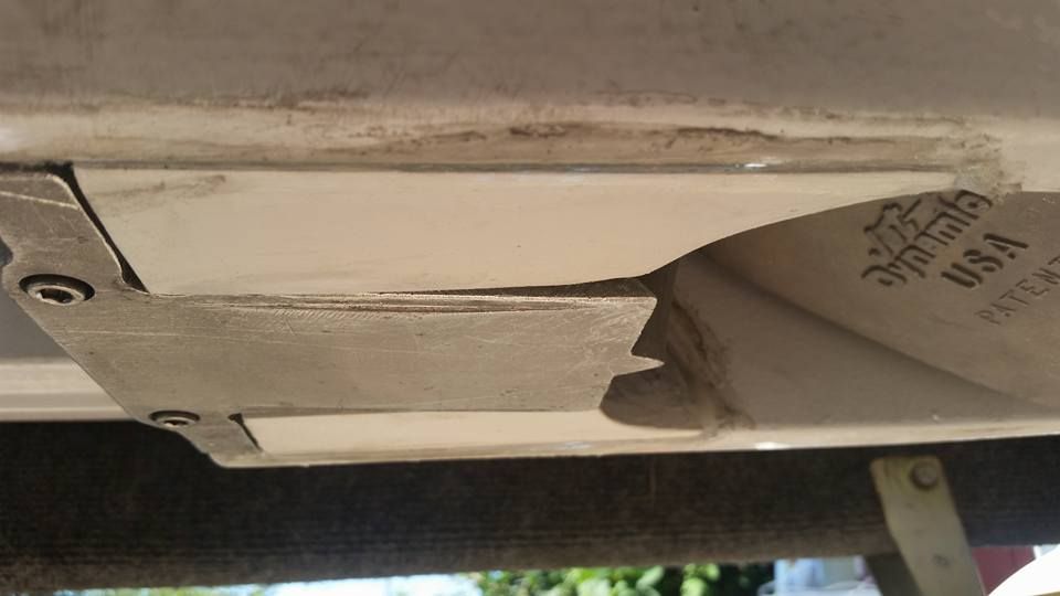

    I ended up picking up a new solas 14/19 ke-sc-i. put my RPM right at 7000 wide open. so far, my best is 52.61@7050RPM on chop. I need to be closer to 7200 according to Art so thats my goal. my 13/18 is a ke-sc-a which is slightly damaged and an old version. they have a new updated version ke-sc-s that I plan to keep an eye out for, I think its the key. not looking to buy one this summer, Ill probably just play with the wet wolf if I can find it. if the 13/18 fails, ill get a repitch. as it sits, from a dead stop it now just hooks and goes!
    I also modified my scoop and pump shoe so it actually fits correctly. it took a lot of jb weld.. and a lot more grinding.. but it fits! and holy hell what a difference! it rides great!! not sketchy at all now! I did that the same time as the 14/19. I MIGHT swap the 13/8 back in to compare the difference. I also didnt seal the ride plate or scoop grate up so I might have a tad more speed in that too.. and trim.. have yet to finish that too..
    the white on the pump shoe is JB weld lol. hope it holds up.. I cant weld aluminum yet..

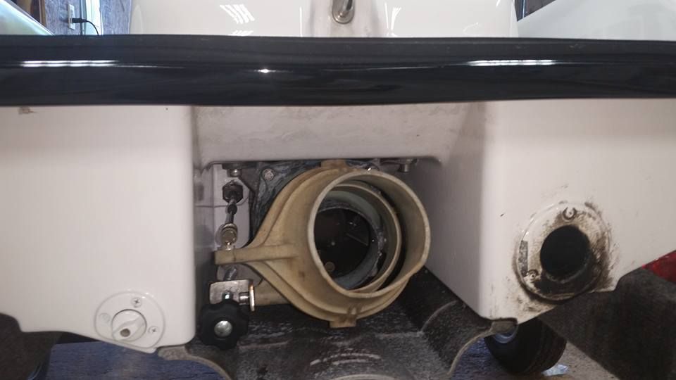

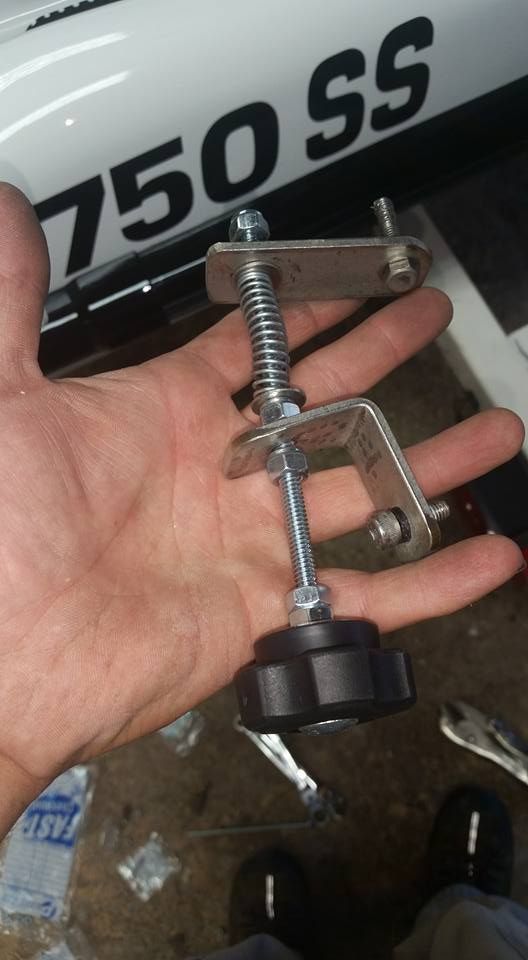

    finally got around to building my trim setup. Inspired by the seadoo HX and no wanting to drill a hole in this hull.
    up all the way
    all the way down
    center

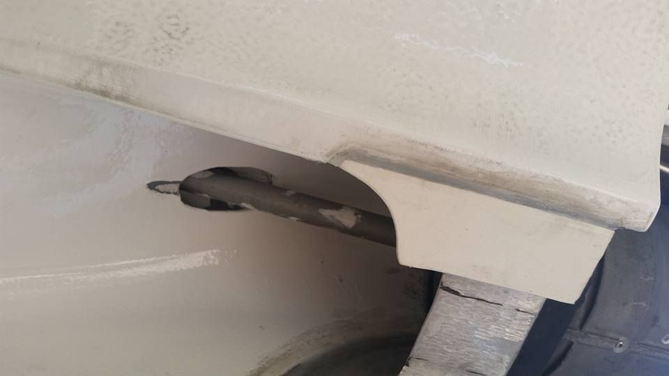

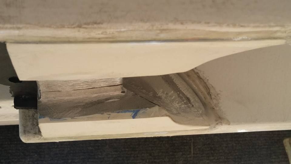

    since I was at it, I thought I would post my steering angle for my modified steering. ill get a picture of how I did that at some point..
    ignore the ugly nozzle, I do have a mint one ill toss on someday, but it would have to be modified again to get this angle. (steering pole and nozzle were modified)
