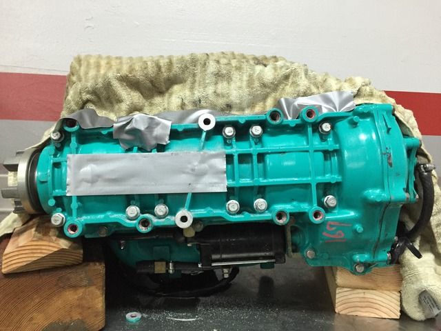

    Triple is out! Pop an advil for the backache…
    Question #1 - Answered! Engine weights 128lbs with only the exhaust removed. It will be reduced a little bit since we are not using the ZXI bed plate which weighs 12lbs. Exhaust weighs 18lbs. Heavy for sure.

    The triple savvy guys will know this - The Kawi triples actually have 10 tapped motor mount holes in the cases. Six holes mount to the ZXI bed plate, the other four are unused and are the exact bolt pattern of any 650/750/800 engine - quite convenient! SXR1100 conversions take advantage of this.
    So, if a triple will bolt to an SXR bed plate, then a triple will bolt to a 550/650 conversion plate - which bolts to a 550 bed plate, right? Yes! Well, with quick mods.
    Also, I’m using RHAAS 550 to 650/750 conversion plates because they allow you to position the engine about ¾” further back than a standard conversion plate. All this weight needs to be as far back as it can get.
    Mods are simple, the middle two ZXI Mounts need to be clearanced 5mm.
    During surgery…
    All cleaned up. Mounts are right about flush with the reinforcing rib on the cases…
    To install the bed plate, one engine mount bolt needs to be shortened or it will contact a reinforcing rib. It still fully engages all threads in the conversion plate.
    Bed plate installed (Will be painted before final install)
