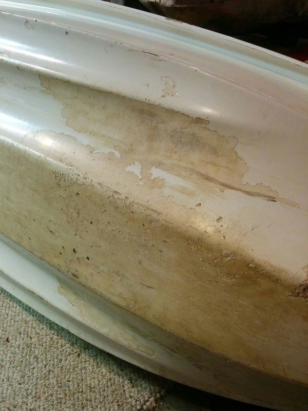

    these skis sat unprotected outdoors for 3 seasons on the trailer. the mold and filth was real. Scrubbing bubbles = the bomb. Here is the current state of the hull.
    Originally I had really ambitious plans to overhaul the hull with foot holds and drop some money on professional grade paint. now that I have it in front of me, I'm skeptical that it is a good idea.
    here are the issues:
    1. tiny cracks where the pole bracket mounts
    2. decent sized damaged areas that require substantial repair
    3. factory paint is bubbling/flaking
    4. the deck has a hump in it ()
    I assume that the hump is due to water getting in the foam underneath, then sitting outside in north Georgia for 3 years. Frozen/thawed/frozen/thawed = warped
    Should I just go for the foot holds, and have the chance to remove any soaked foam below deck?
    See how the paint is flaking off the gelcoat? (gelcoat under, right?) what should i do about this to get a good surface to paint on?

    what should i use to even out the flaking/bubbling paint? sand it, prime it, sand it, seal it? I could get after it with an orbital and take it all off? I don't want the old paint to flake and bubble under the new paint, you know?

    Find and mark all the bad/flake spots and sand them down and feather the edges, then prime well. After that you may want to sand the whole hull to make it slightly rough and repaint the bottom.
