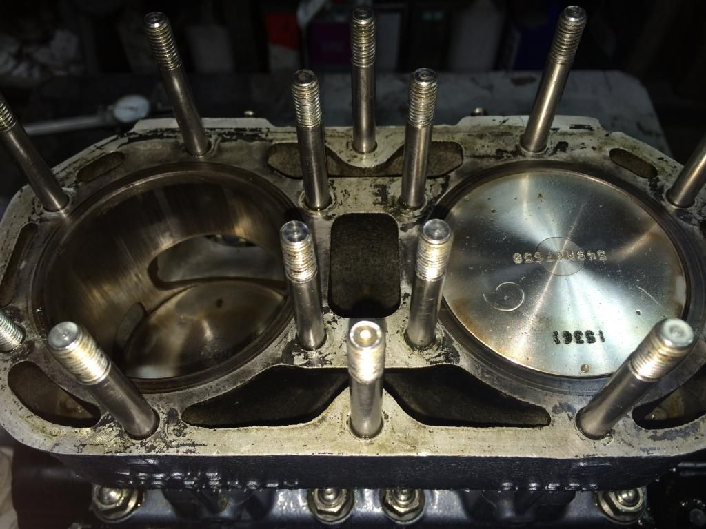

    Hello everyone!

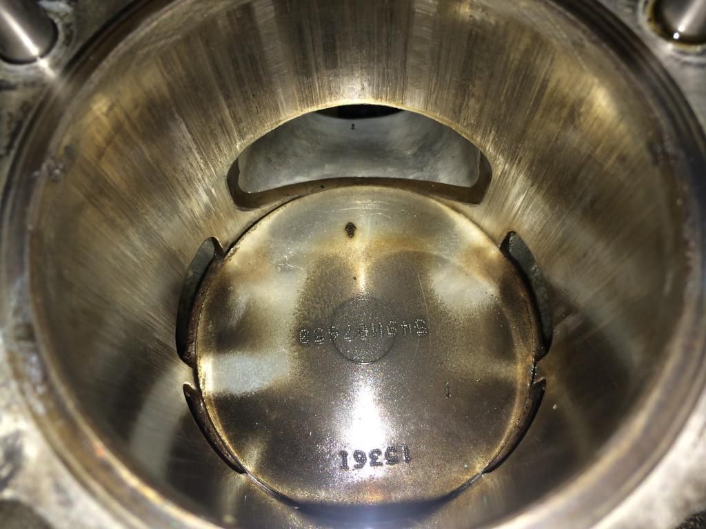

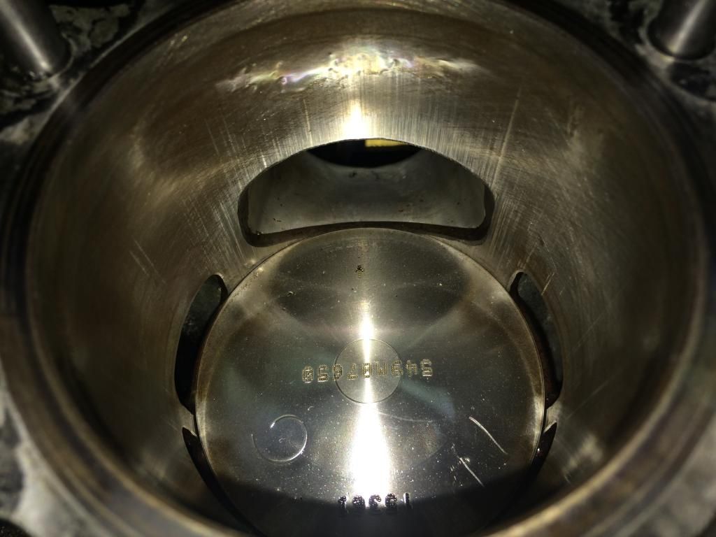

    I have plenty of pics and info Bill.
    I must say I am so grateful for you taking the time to look at this situation for me, otherwise id be really struggling!
    I got some shots of the pistons etc at both crank phases, the rear is on the left:
    Front:
    Rear, you can see the bore damage here:

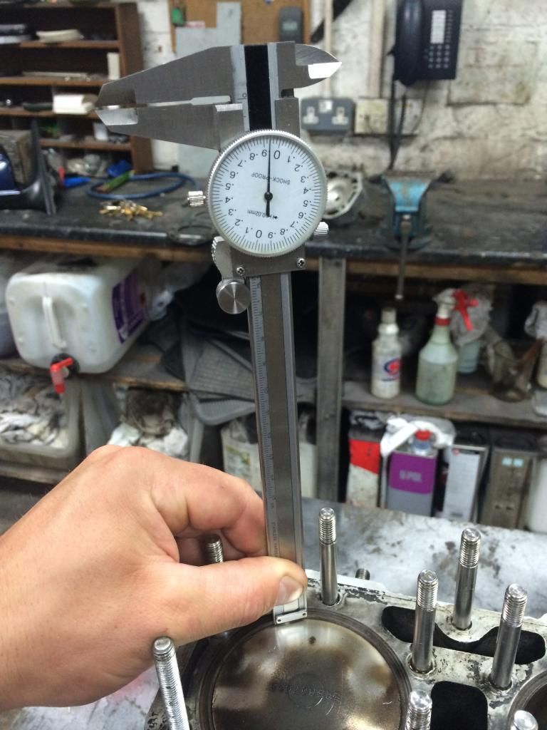

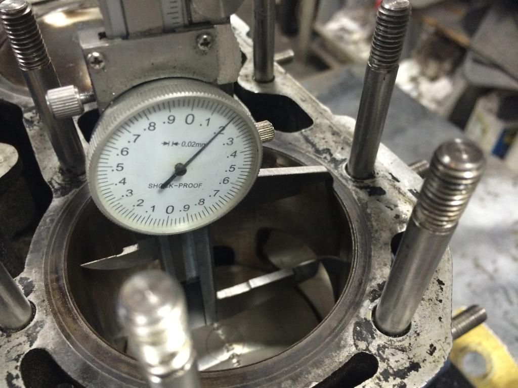

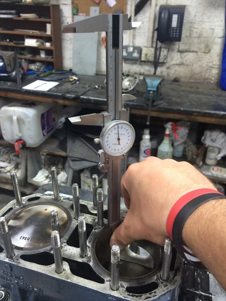

    Then I took the piston crown to deck height, it wasn't easy because of the small measurement and the piston crown did not give a level surface:
    Front 0.84mm
    Rear 0.94mm
    And then BDC to deck:
    Front 70.84mm
    Rear 70.82mm
    And then top of exhaust port opening to deck:
    Front 38.20mm
    Rear 37.80mm

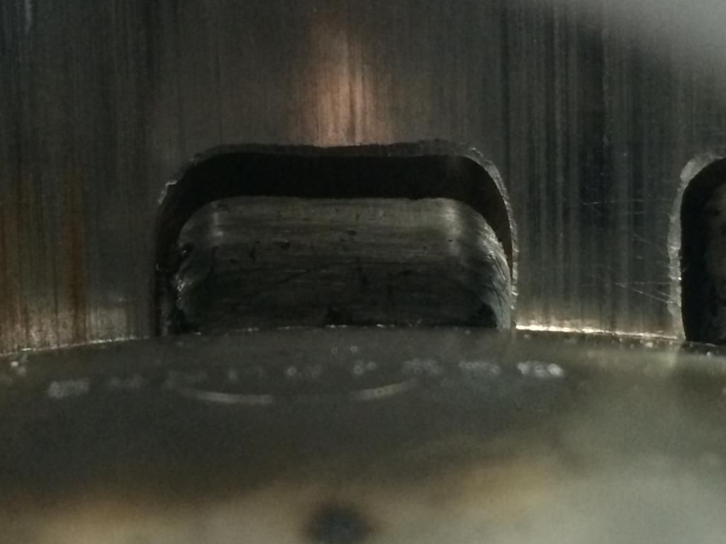

    Then I took the centre transfer port to deck, these have been angled upwards quite a lot I think:
    Both front and rear were around 57.00mm to deck, all ports are approx level.

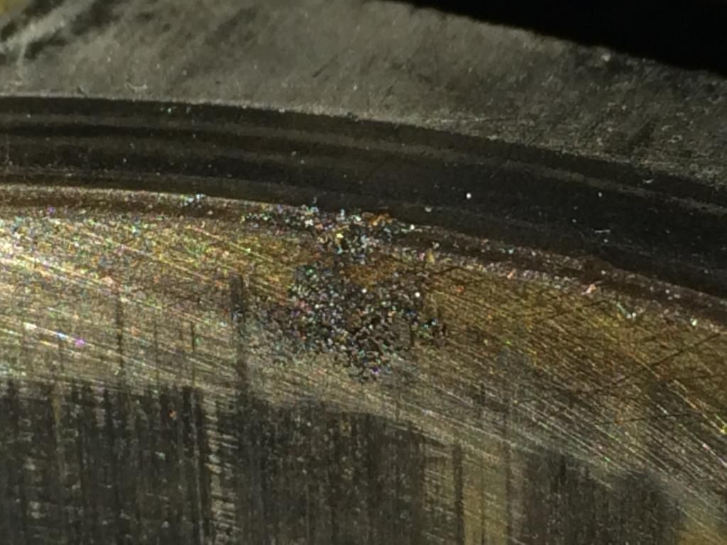

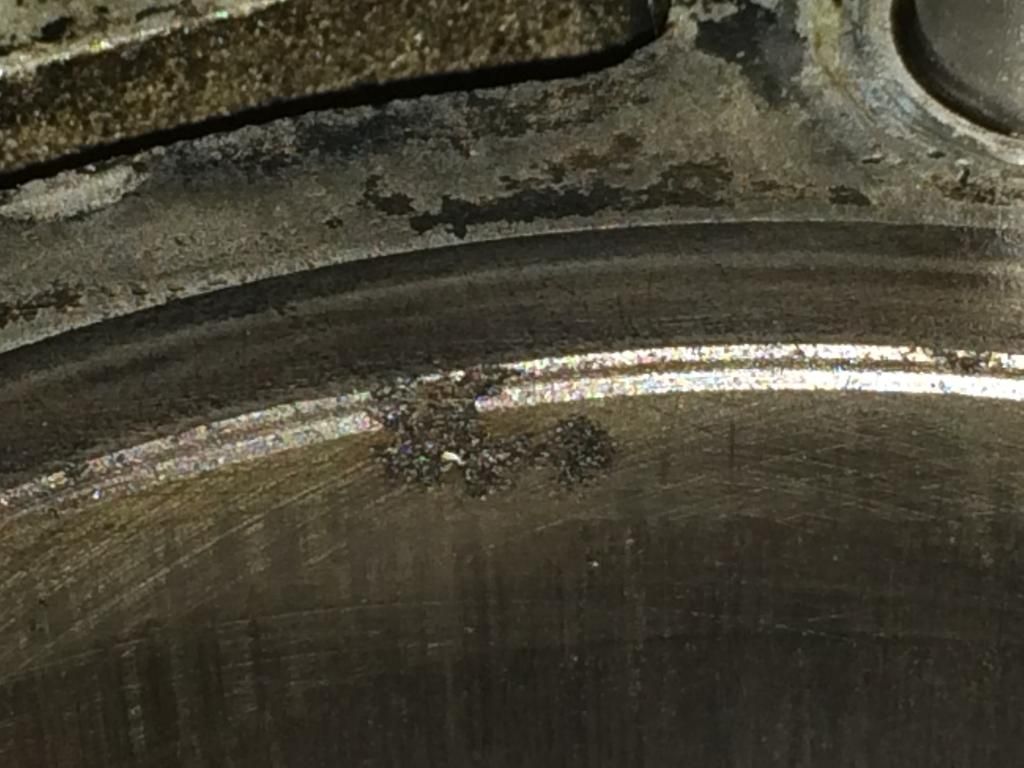

    Next, I took a couple of pics of the pitting on the rear cylinder, although now I think it may just be corrosion???
    Only thing is I'm not sure I had seen it before.

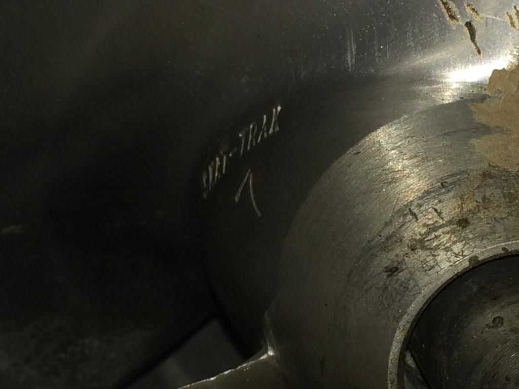

    And then finally I checked out the impeller, it's a Skat 7:
    Really hope you can make something of that lot Bill, I owe you a beer!

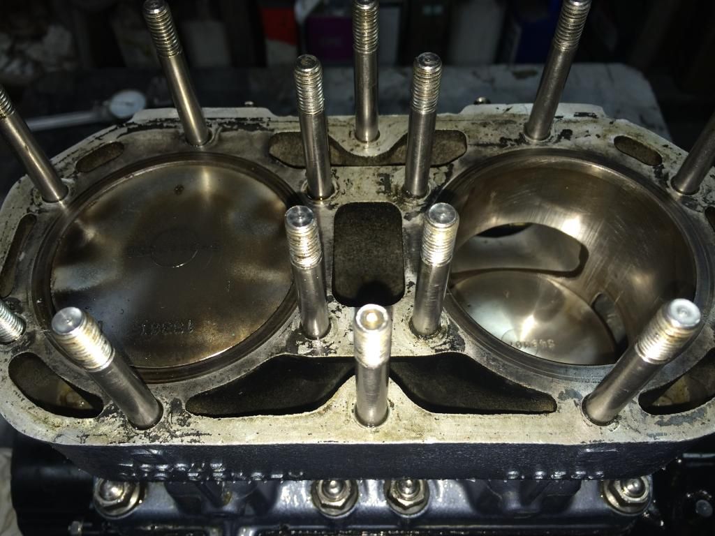

    Re: Trying to setup dual 38 carbs for very hot 650 X2!
    I don't have enough time to give a full answer now, and there is plenty
    to talk about. Your exhaust timing is close to 190 degrees of duration.
    It looks as though you have had a history of blown head gaskets, and
    the impeller appears to be a 17 degree straight pitch. If I am correct,
    that is a real bad combination, and it would seize no matter what
    carburetion was used.
    Note: Anyone, if you can identify that impeller as something other
    than a 17 degree impeller, please speak up. Other possibilities are a
    14/17, or a 9/17.
    Bill M.
    That's ok bill, no rush.
    The head gasket has warped and there is evidence of blowing or at least very hot spots in the gasket around the bore.
    After some research, I'm quite certain it's a straight 17 impeller.
    The cylinder was from a westcoast works racing ski, hence it's wild setup perhaps.
    I look forward to your thoughts, somewhat apprehensively!
