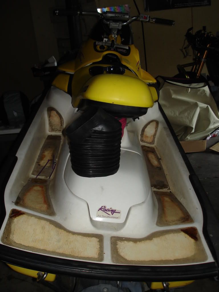

    I had been working like a dog for a few days to get the new trailer and tow vehicle ready for this past weekend's camping trip. I didn't bother bringing the HX since it's still an unknown quantity. I did get it running on a 3 gallon 110-2 gallon 91 blend and the motor sounds very healthy and LOUD (not water box). I'm going to finish the last few things it needs before beating on it for the rest of the summer. First things first, I finished peeling the stock mats off:
    Now I begin the arduous process of remove most/all of the old adhesive. After that, the buffer/polish comes out and I'll restore the foot well area. The new shock boot arrived and will go on after the buff/polish. I also received the hot products cap:
