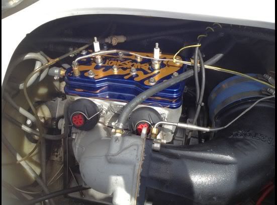

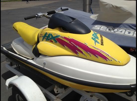

    I've always wanted a stock HX just to play around with. So when this popped up a few days ago on a local classifieds I quickly went to the bank and got the necessary cash-wad:
    As you can see, it's far from stock. The current mods are:
    UMI steering w/KVP billet throttle and switch box
    Hot Tach Race pak w/EGT and water temp probes
    Manual bilge
    VE920 jugs with watercraft magic porting
    custom stainless steel cradle
    Novi 46mm carbs
    watercraft magic billet intake manifold
    Buckshot head w/35cc domes
    Factory spec 1 pipe
    Reprogrammed MPEM for extended ravs
    I'm not sure what it has for a prop, but it appears to be some kind of aftermarket swirl. I'll be pulling the engine for a thorough cleaning and inspection before I attempt to take it out. I'm not very keen on the 35cc domes since they will require 110 octane which is currently $7.50/gallon in my area. I won't be digging into too deeply until the fall when it will get the full Jettrim/Hydroturf/buff&polish/carbon vinyl wrap/paint treatment!

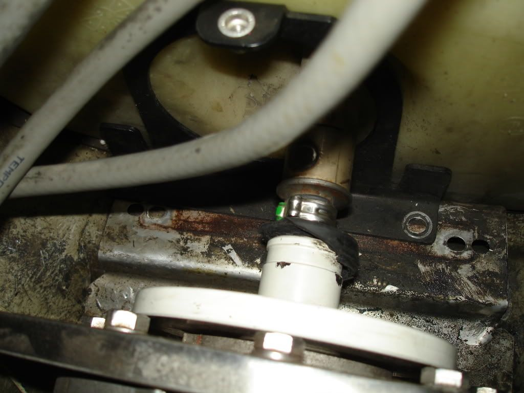

    I'm starting in on it this week. This will need to be addressed:
    I'm thinking about pulling the motor to get the bilge clean and will replace that boot at the same time.
