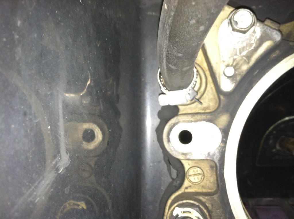

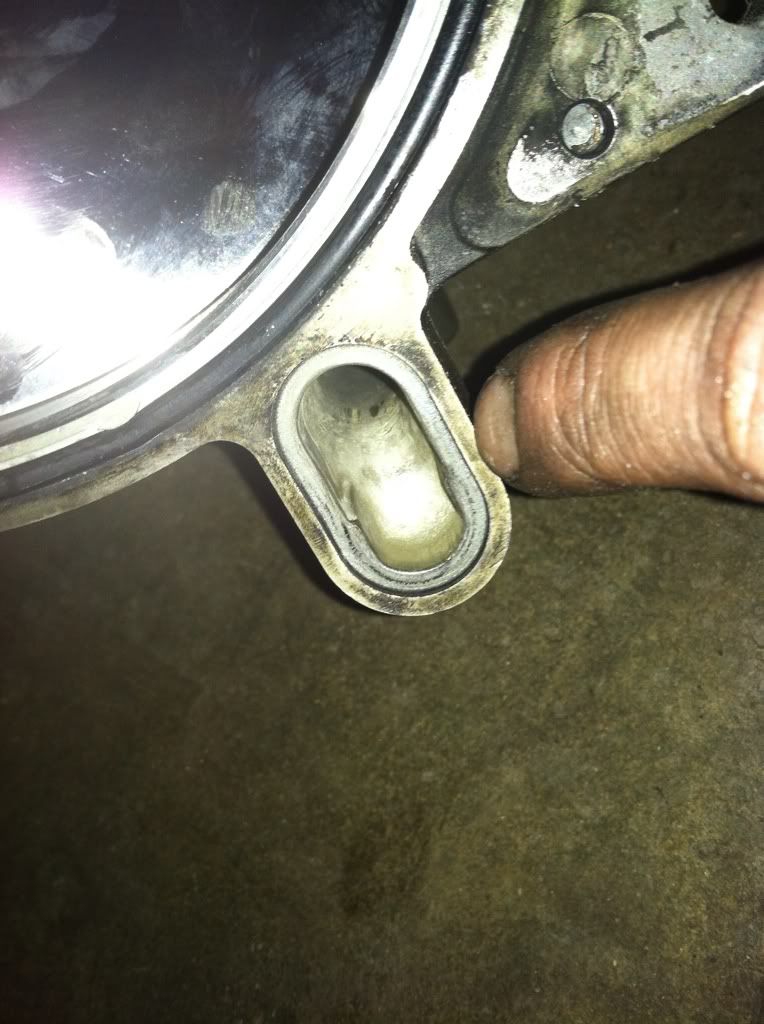

    Last weekend i took off my pump, intake grate, and ride plate to do some modifying. I'm at the shop now getting ready to put the pump back on and i notice the gasket between the thrustplate and pump is missing. Do any of you happen to have one laying around? I was wanting to take it out next weekend to test some of my mods, but it's not looking very good right now. Here's a couple pics of where the gasket goes:
    Is it number 17 in this diagram? It's the only thing i see close to what i'm looking for. I don't want to buy the whole thrust plate just for this one gasket.

    It is #17 in the blowup. It is a big chunk of rubber with an angled offset hole that adapts the pump's internal line into the hole in the thrust plate.
