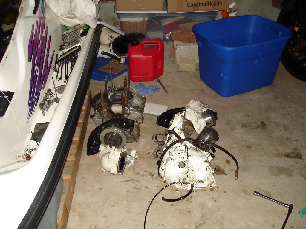

    I acquired this 1998 XPL with a bad motor, new pump, new seat cover (uninstalled), new hydroturf (uninstalled), aluminum shop stand, and new R&D plenum this past weekend. I really want this to be a fun, reliable rec ski in the end with a little extra punch.
    Here she is before the tear-down
    The previous owner said it had a small hole in the block from when it tossed a rod and they he thinks it can be repaired. Now, truth be told the hole did look small on the balance shaft side, however I found this when I pulled the carbs and motor:
    Obviously these cases are DONE. So I'm on the hunt right now for a new set of cases to either use as an SBT core or to build up. In the meantime I'm going to restore the ski's aesthetics to better than new.

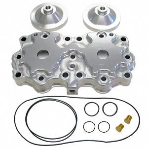

    Carbs have been shipped out to Watercraft Magic for rebuild/rejet/flame arrestor treatment. I also picked up an ADA head with 52cc domes:
