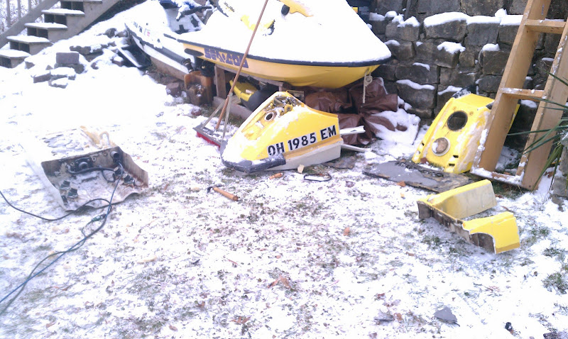

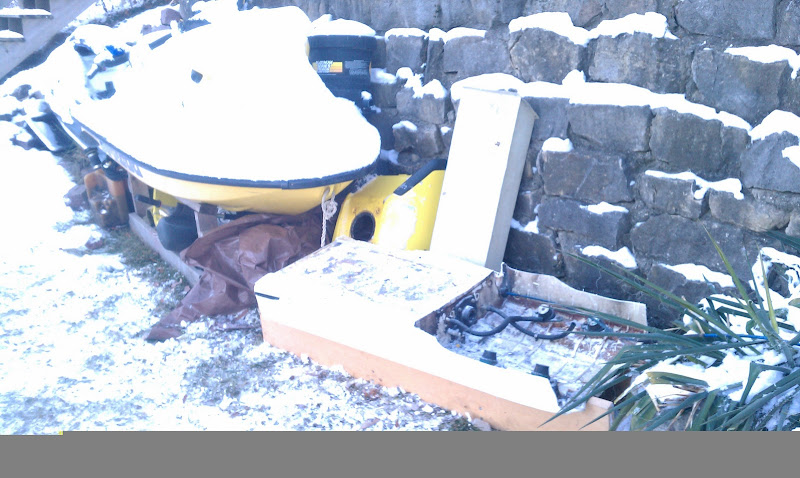

    So today was basically the first day of this build. I picked up a 12' Jon Boat in very good condition for $300 over the weekend. (pictures). Now originally i was planning on throwing this thing together quick but I have since decided that I have all spring to work on this so I am going to take my time and try and see if I can't produce something of quality. I have a couple pictures of the donor ski and the jon boat for you. I didn't get a chance to snap any pictures of what I finished today. All i did today was remove the rear seat in the jon boat. pull the motor, electrical box, coil, and strip all the bumpers and vinyl. I started to disassemble the handle pole but ran out of time. I will snap some pictures tomorrow morning when I start. My plan for tomorrow is to finish stripping the hull of basically everything but motor mounts and the entire jet pump assembly. If I have time I will start to cut some of the hull. Mostly just because I need to clear space so this isn't an eye sore.
    Question for vintage kawi guys I would really like to chop the hull down to the bare minimum. Obviously it is going to be secured and enforced by the jon boat. My plan is to basically chop the front of the hull just after the forward motor mounts and then just to the sides of the mounts. I really want to be able to use the entire drive setup of the ski and implant it basically in a big chunk into the boat, without having it look like i dropped a ski in a jon boat. The only problem I see right now is that I would like to cut the sides of the tray off so that it is more like a flat deck but if I do that won't I need to fiberglass the cut section as the bolts for the jet pump would essentially be then attached to a floating piece of fiberglass. I have not ever seen exactly how that support structure works. Would I have to glass over those? I do not want to do any extensive fiberglass work and I cannot for a couple more months till ambient temperature rises.
    ** I understand that I will need to add reinforcing on the jon boat after removing the rear seat and setting the motor in the which is going to want to flex the floor under load.

    Worked on the boat a few hours today. I was able to answer my own question from the previous post as far as support for the pump. So today I more or less finished up chopping the hull. I removed all of the working components from the hull aside from the jet pump assembly and the motor mounts. I had more time but I figured it would be better spent cleaning up and organizing things. The next step now is to start cutting my holes in the jon boat. I had my dad come down and give me a second opinion where I should cut the boat and secure the two pieces. We came up with a pretty good plan for securing that. I may start that tomorrow. The plan is really starting to take shape in my head now that I have all the pieces in front of me.
    Pictures from today, sorry they came out horrible.
