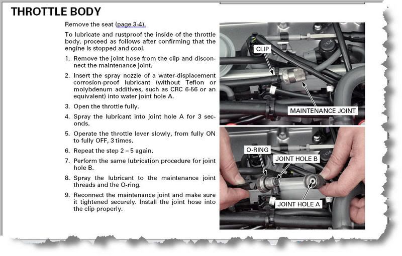

    The pictures are not longer working. Could someone post pictures of where I need to lube the turbo? Thanks

    And lube this...You will need to reach for it on your F-12X...you can spray in that direction, then rub it in with your hands. The turbo and this thing below are the two most important things to lube. I do it after every ride.
    Spray that thing in red (Wastegate Link) and the thing to the left. That is the Turbo. The throttle body is a cable on top of your motor. It is silver and unscrews. I spray inside of it...and I spray the outside of it. It unscrews by hand. Here is a step by step pic I tore out of the book for you.
